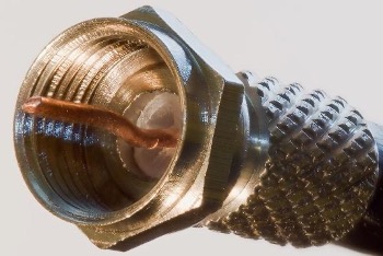

F Plug (Antenna connector)
A single coaxial cable with Type F connector. This type of connection was much more common in North America (USA, Canada).
On a single cable, both audio and video signals pass, which strongly impacts the quality of the rendering, it is generally the one that gives the worst final rendering to the screen

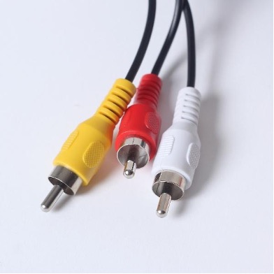

RCA Composite
Three RCA connectors Red, White (for stereo sound) and Yellow (for video signal). The video (and synchronization) signal being separated from the sound signals, the quality of the rendering is superior to a signal passing through an F plug
RCA
Quite widespread in Europe, arrived later in North America (arrived from the generation of 16Bits consoles).

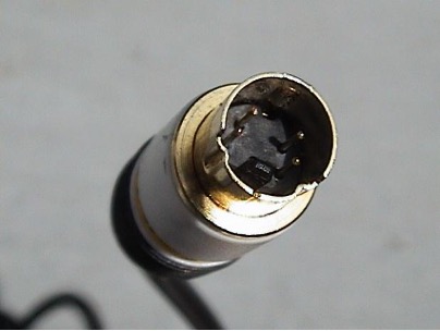

S-Video
A 4-pin connector carrying only the video signal (the sound passing through a separate RCA connector)
S-Video
The video signal is separated into two lines, Intensity (or Luminance – coupled with synchronization) and Color (or Chrominance), which reduces the worries of degradation of the video signal compared to a composite signal.

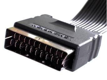

Euro-SCART (Scart) and JP-21
These two connectors are identical but not compatible because the internal wiring is different. They consist of a 21-pin connector.
The Euro-SCART connector corresponds to the format used in Europe and was mandatory on all TVs sold in France since 1980 (and until 2015), while the JP-21 connector is widespread in Japan and Korea.
SCART
It is a connector that can pass several types of signals, there are also on the market composite adapters to SCART or S-Video to SCART, however these passive adapters do not improve the quality of the initial signal.
The audio signal passes in stereo on two dedicated pins.
On the other hand, thanks to the many pins present, it is possible to transmit more complex signals, such as an RGB signal.
The RGB signal passes through three different pins the different red, green and blue colors needed, as well as a synchronization signal (horizontal and vertical) of the image on a fourth pin.
This synchronization stream can come from different signals sometimes existing depending on the source:
Composite video as sync: Retrieves the composite video stream directly to use only the synchronization information. The video stream, however, can interfere with the synchronization stream
Sync on luma: retrieves the signal from the S-Video luminance stream
Csync: contains only the synchronization signal and is therefore not subject to interference from another signal passing through the same pin, it is the one used by Recalbox RGB Dual
It is this connector coupled with an RGB signal, synchronized in Csync, which makes it possible to obtain the best rendering on a cathode ray TV.

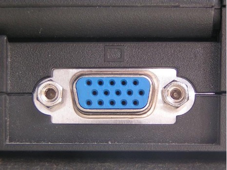

DSUB - DE-15 (commonly known as VGA)
This 15-pin connector is prevalent especially on computer screens, and is generally absent from CRT televisions.
DSUB
It transmits an RGB signal on three pins like the scart, as well as two separate synchronization signals (horizontal and vertical) on two other pins.

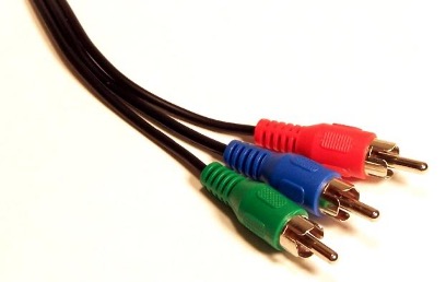

YPbPr (commonly known as Component or YUV)
Composed of three cables with RCA connectors for video streaming (sound passing through a separate RCA connector).
YPbPr
This format is more prevalent in North America and arrived on the generation of PS2/Gamecube consoles.
It is a connector that has arrived on the end of life of CRT screens and is also present on flat screens.
The video signal is separated into three distinct streams:
Y: Luminance and synchronization
Pb: Difference between blue and luminance
Pr: Difference between red and luminance
The signal for the green color is generated by deduction with the other three data.
This signal separation improves video quality compared to the S-Video connector and allowed some TVs to display higher resolutions such as 480p.
