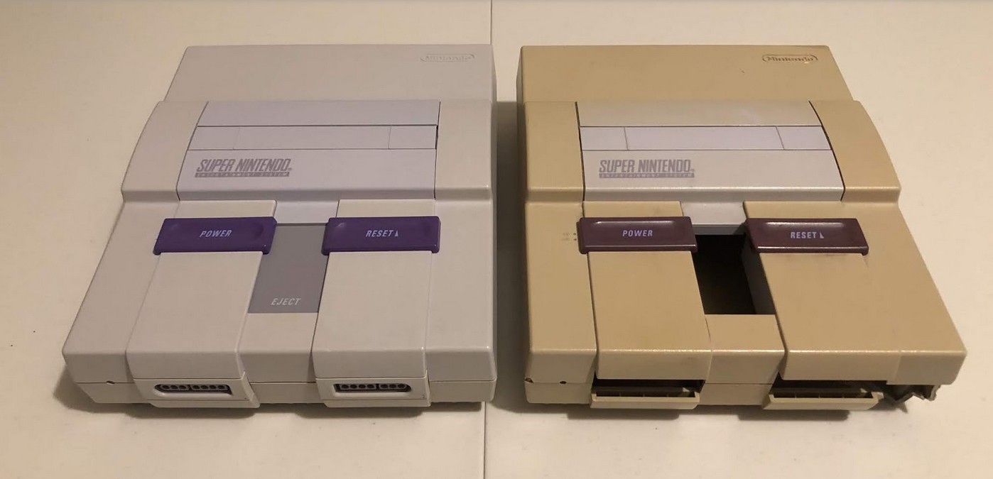

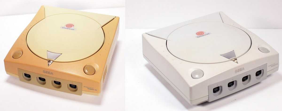

If you own a Super Nintendo, a NES, a Dreamcast or an old Amiga computer, you’ve probably noticed this frustrating phenomenon: the original light-grey or white plastic has turned yellow, sometimes even brown in the most extreme cases. This yellowing, which mainly affects consoles and computers from the 1980s and 1990s, is no accident. Here’s why it happens — and what people have tried to do about it.

One of the most frustrating mysteries: on the same Super Nintendo, the top shell can turn very yellow while the bottom half remains perfectly grey. Several explanations exist:
Different production batches: Only certain batches had this issue, and later SNES models no longer suffered from it. Nintendo seems to have adjusted the flame-retardant dosage during production. The top and bottom of your console may simply come from two different batches with slightly different compositions.
Uneven exposure: The top of the console is much more exposed to light than the bottom. More UV = more yellowing.

Variable results: It works better on some plastics than others. Game Boys, NES consoles and controllers generally react very well. Grey consoles can be trickier.

A recent article on Time Extension also reports negative experiences, notably on a Dreamcast.
